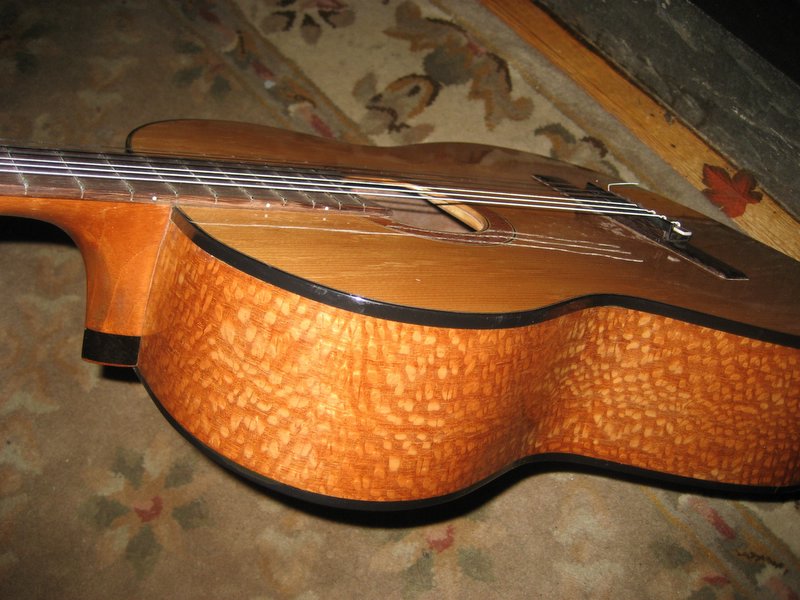

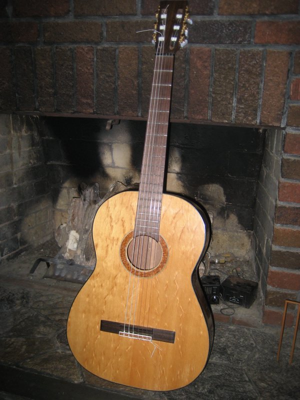

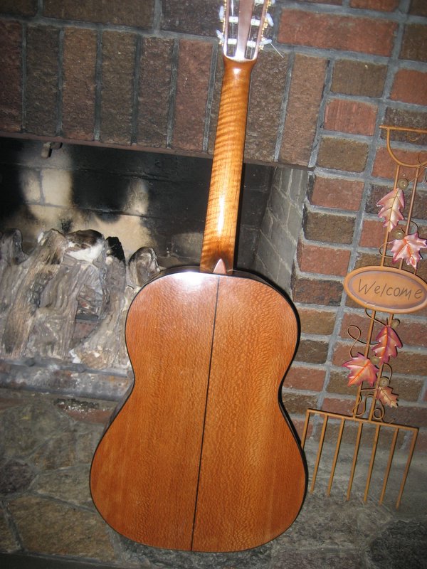

Here are some pics as promised of the classical I finished up recently.
Now for the problems. I posted some of this a couple weeks ago and it generated a good amount of feedback (which is always appreciated).
Problem: Poor volume and dead sound. No ring on the upper strings.
Feedback indicates I probably over built. Soundboard was around .11 and used Sitka Bear Claw with lacewood back/sides. Hauser body dimensions.
One suggestion was to use high tension strings which I put on tonight and they did help.
Also seems to have gotten a little better on its own from playing for past two weeks.
Went down to the Guitar Center today and played a bunch of classicals ranging in price from $99 to $2,000 range. Mine sounds like those in the $199 range which is pretty disappointing but hey I am having fun and good learning experience. Sure looks impressive on my wall
Now for my remaining problem. The upper strings do not have any ring to them. Base strings are ok.
Especially puzzling is the G string sounds dead dead dead.
Thought maybe I had a problem with the nut seating so I put a capo on to check it out and still kinda dead but seemed slightly better.
I used black horn nut and saddle. Is it possible this would make that much of a difference? Thinking of going to a bone nut and saddle
Good clearance in the nut slot - no binding and strings are slightly raised above the nut channels.
Fret board seems good and level as well as frets.
Good action (maybe a little too low).
I think my break angle is higher than it should be as a result of setting the neck angle as I do with steel strings
Straight edge was dead on top of the bridge with frets installed
I considered removing neck and bridge and taking down the soundboard some but to tell you the truth I dont have the patience to rework stuff. Might just jump in and buid another from more traditional tonewoods and learn from the experience.
What do you think?? Give it to me straight - don't pull any punches. Should I use it for target practice? Hang it on the wall of shame?? Put a clock and radio in the sound hole and use it as a wall hanger? Give it to one of the grand kids and let them learn guitar??

Oh yeah - one more thing. That black ebony addition to the heel was what I call an original innovation
Now for the truth!! Messed up with the carving of the heel and had to make up for the resulting short heel.

My first suggestion is to try carbon strings or Hannabach Goldins. This may be enough to help the trebles.
Could you post the bridge dimensions? Length of the center section (same as length of saddle), height, height of wings, and width and length of the bridge.
Also, if you could post the dimensions of the braces that would be helpful.
Neck dimentions would also be helpful - width at nut and 12th fret, and especially the depth (1st and 8th fret). Thinning the neck may increase volume.
My first inclination, if the asked for measurements were fairly standard, would be to thin the soundboard behind the bridge and at the edges. You could do this while she is strung up and get a good idea of the effect.
I'd also like to know how far the strings are from the soundboard.
I have not used horn for the nut and saddle, but it is possible you will get a better sound with bone.
Your guitar has a great deal of potential, way beyond a $199 GC guitar! You also have a great opportunity to learn from changing things. jfrench39007.0891087963

First: the G string is always a problem on classicals: if you can get that right most of your other problems will be solved as well, I think.
The word that comes to my mind is 'damping'. Lacewood has pretty high damping, bearclaw figure in a top tends to add to damping, and the horn you're using mmay also have higher damping than bone. Damping tends to 'eat' high frequencies, and since there is not as much energy in the highs in nylon strings you can't afford to waste any of it.
In addition, top wood with that sort of bearclaw figure is generally cut pretty far off the quarter, so the cross grain stiffness will be low. I have seen one piece of spruce with that sort of figure that you could have wrappped into a tube. It looks cool, but it makes the top a bit 'flabbier; than it ought to be.
There are probably things you can do to make it sound better than it does, and the effort will teach you a lot, but don't expect too much.
